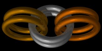

Step 1: Make a 2-2-2 chain as shown.

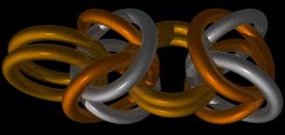

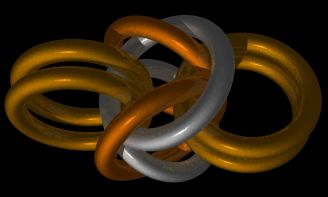

Step 2: Fold the rings on one end of the chain back.

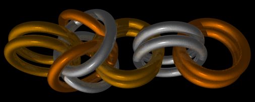

Step 3: Connect another 2-2-2 chain to the folded-back part of the previous one.

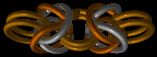

Step 4: Fold the end of that chain back as well.
Step 5: And lock the folded-back rings into place with a new pair.
That's it! Just repeat steps 4 and 5 to lengthen the chain. Not too bad, eh?
