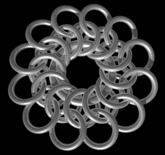

Step 1: add some closed rings to an open ring and then close that ring. Lay the group out as shown. The single open ring (sometimes referred to as the "queen ring") will be the center of your coif. You want to pack a fair number of rings onto the queen ring, but you still should not have any problems getting the rings to lie more or less flat. None of the rings should be pushed into the middle of the queen ring because of the density of the rings. To make this easier, use a larger ring for the queen ring - 3/8" ID if you're using 5/16" ID rings, or 7/16" ID for a 3/8" ID piece, and so on. Call the outer rings Row 1.

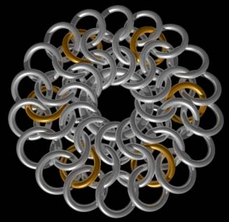

Step 2: Add another row of rings in the Euro 4-1 style. That is, add another row of rings such that each ring passes through two adjacent rings in the previous row. I'm sure you can figure it out. Call this Row 2.
Step 3: Go around the circle adding rings through Row 1, in such a way that the rings only pass through one ring in the row. Space them regularly. They should not pass through Row 2 rings.

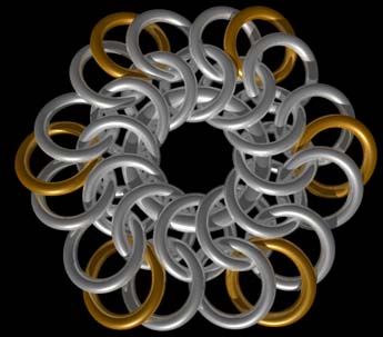

Step 4: Now add onto that row of normal and expansion rings. Each ring that you add should pass through two of the rings in the previous row, whether they be normal or expansion rings. Notice that each expansion ring now passes through three rings in total - one ring near the center and two in the row you just added.
Step 4 Step 5
