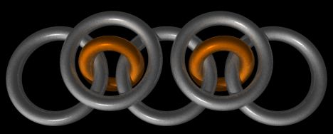

1: To start out, you want to make a simple 2-1 chain of alternating large and small links:

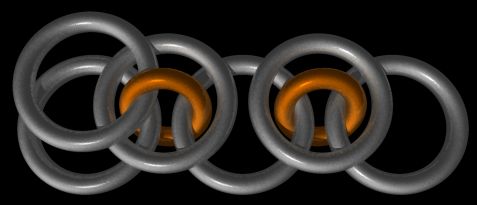

2: Now place single large links over the small links in the chain. These new links should not pass through any of the chain links; they're just lying on top.

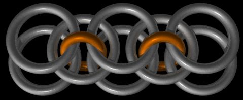

3: Pass a new large link through one of the small links in the starting chain. You should do this so that the link you added in the previous step gets locked into place.

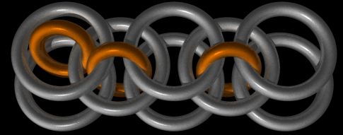

4: Add another large link through two of the small links in the chain - the one you just used plus its neighbor. In the process you should lock in another of the large links you added in step 2. Continue adding links in this fashion until you reach the end of the piece. In this case, that's just one more ring.

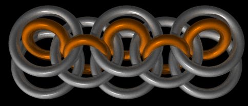

5: This step's a tad tricky. You'll need to connect those rings you added in step 2 to each other using small links. You may have to flip the patch over to reach the links, depending on how tight your weave is.

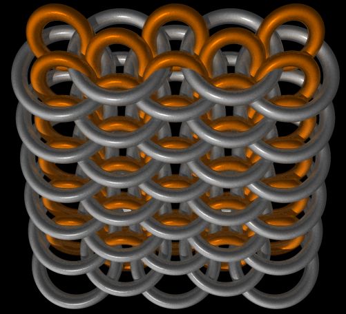

7: That does it! From here on, you should be able to repeat the pattern to make the weave longer. Have fun!
