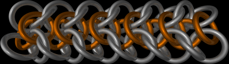

Step 1: Build a 2-1 chain a bit more than twice as long as you want the eventual finished piece to be. Find the middle link (in this image, colored copper), and pull it out to one end so the rest of the links are paired up. Try to line up the links in the chain as shown in the image; at the very least, you'll need the ones closest to the middle to be as shown.
Step one

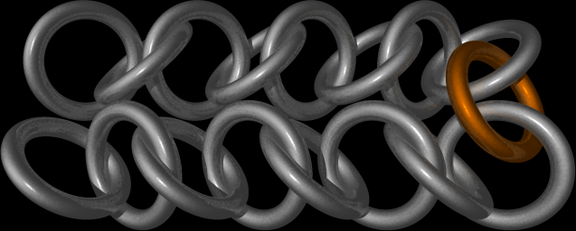

Step 2: We're going to go down the chain and lock in adjacent pairs of rings. Take a new ring and pass it through two adjacent rings on one side of the chain, and then their counterparts on the other side. If you line up your chain so that the base (the first copper ring) is close to you, then you should start on the right-hand side. This way, when you're done adding the ring, the closure is in an easily-accessible location.
Step two

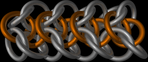

Step three: Now just keep adding rings like this down the length of the chain.
Step three

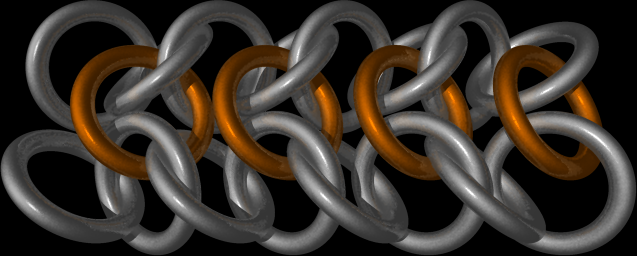

Step four: We're going to have to do the same thing to the underside of the chain, so turn the chain over. No rings are added in this step.
Step four

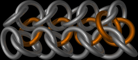

Step five: Just like in step two, add a new ring through the four rings closest to the end of the chain.
Step five

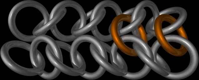

Step six: And just like in step three, continue adding rings down to the end of the chain.
Step six
