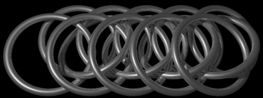

Step 1: Pass four closed rings onto an open ring, Close the ring and lay the group out as shown.
Step 2: Place two closed rings onto an open ring. Pass the ring through the rightmost closed rings from the previous step.

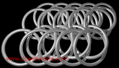

Step 3: Continue that step to lengthen the chain. Make it slightly longer than the final sheet should be wide, as adding the next row will constrict the weave slightly.

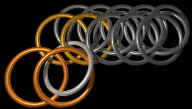

Step 4: Go back to the front of the chain. Place two closed rings on an open ring. Pass the ring through the two leftmost bottom rings on the chain.

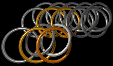

Step 5: Place a single closed ring on an open ring. Pass the ring through the rightmost closed ring from the previous step and two closed rings from the chain above.
Step 6: Continue that step to the end of the chain.

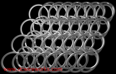

Finished Half Persian Two in One, sheet Four patch:
