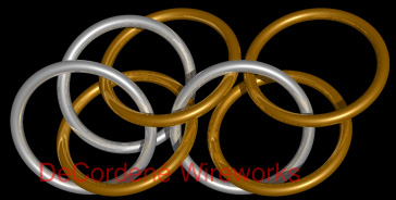

Step 1: Make a little unit like this. Put rings 1 and 2 on ring 3. Pass ring 4 up through ring 1 and down through ring 2. This is a simple Half-Persian stitch, and it forms the basic unit of Not Again.
Step 2: Put two closed rings on an open ring. Pass the open ring through the two right-hand rings in the unit you made in step 1.

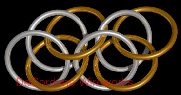

Step 3: Pass a new open ring down through the upper-right ring and up through the lower-right and upper-left rings in that area. Sorry; poor wording. Basically another Half-Persian stitch to finish up another unit of Not Again.

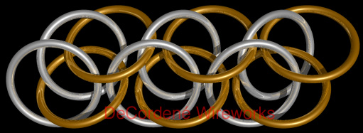

Step 4: Repeat step 2. An open ring carrying two closed rings goes through the two rings on the right-hand side of the chain.

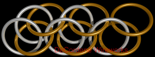

Step 5: Repeat step 3. Do a Half-Persian stitch on the three available rings.

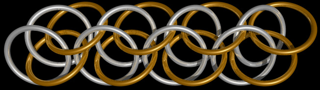

That's the weave. Keep on going to your heart's content.
