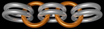

Step 1: Create a chain with three sets of two links connected by two single links, as shown.
step1

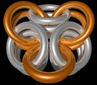

Step 2: Turn the chain into a loop by adding one more ring.
step2
