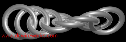

That's it! You can keep adding rings in this fashion until the chain is as long as you want it to be. Have fun!
Finished spiral chain:
