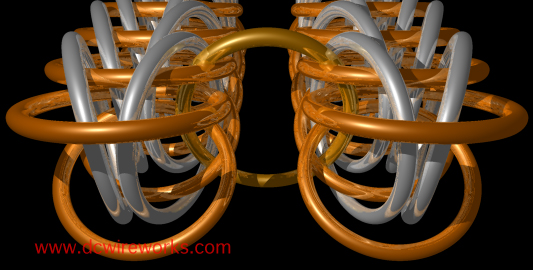

Step 2: Pass a new ring through two of the rings on one chain, and their opposites on the other chain. For this method, the ring should pass through the copper rings, not the silver rings.
Step 3: Continue to add rings in this fashion down the length of the two chains.

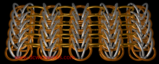

That's all there is to it! Simply create another box chain and connect it to one of the two chains you've already made to widen the weave. Good luck!
Completed box sheet patch:
