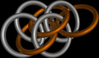

Step 1: Place two closed rings on an open ring and close the ring. Connect the two closed rings with a Half-Persian stitch. Lay them out as shown.

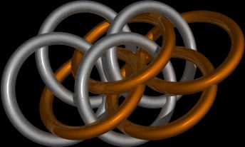

Step 2: As Buddha once explained this weave to me, see the football (i.e. oblong hole) in the copper rings? First, we go through the hole...
Step 3: and then we go around the hole.
Step 4: Once again, through the hole...
Step 5: and around the hole.

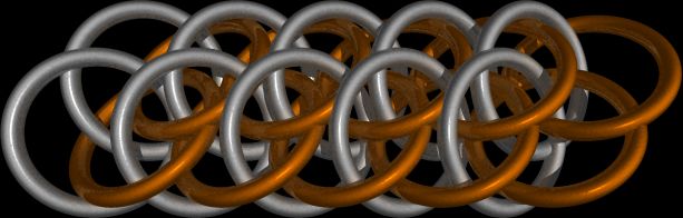

Finished GSG chain:
Finished chain
